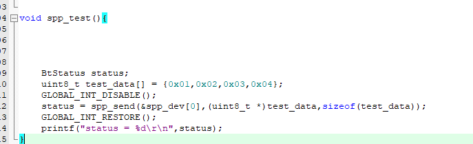

发送 spp协议数据到手机上面 直接死机

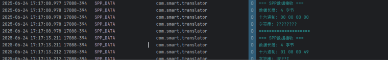

手机端收到的数据如上图 实际发送的的数据是
KEY1 press spp send
status = 2[INFO] me_callback :9,0
Sniff Mode.
: Interrupt frequency too HIGH!
[HardFault]- Stack frame:
R0 = 0x00000000
R1 = 0xF00FF00F
R2 = 0x20007700
R3 = 0x00000000
R12 = 0x1FFE8EAD
LR = 0x1FFE8ED1
PC = 0x1FFE8FE0
PSR = 0x61000024
flash id : ef4018
- Stack frame:
