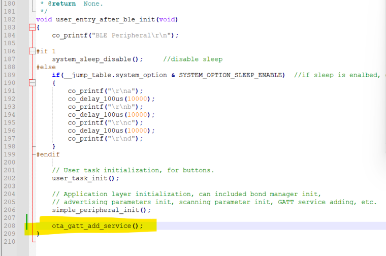

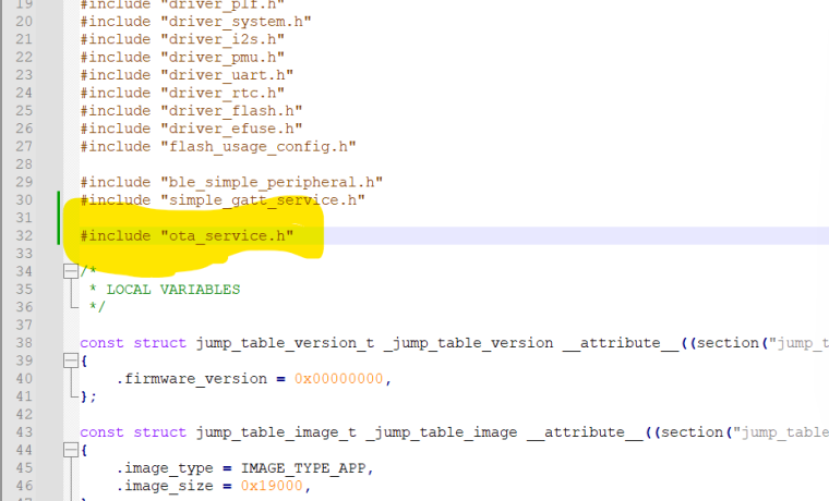

    • RE: 需要提供OTA更新的示例代码 / Example needed for OTA update
      简单来说……假设我想在 https://gitee.com/freqchip/FR801xH-SDK/blob/master/examples/none_evm/ble_simple_peripheral/code/proj_main.c 中添加 OTA 更新功能
      添加这几行就够了吗?!
      Let's keep it simple... let's say I want to add OTA update feature to https://gitee.com/freqchip/FR801xH-SDK/blob/master/examples/none_evm/ble_simple_peripheral/code/proj_main.c
      Is enough to add these lines?!

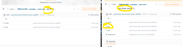

      @felix-yang unfortunately that example does not contain the "gcc" directory and proper MakeFile
      @felix-yang 不幸的是,该示例不包含“gcc”目录和正确的 MakeFile

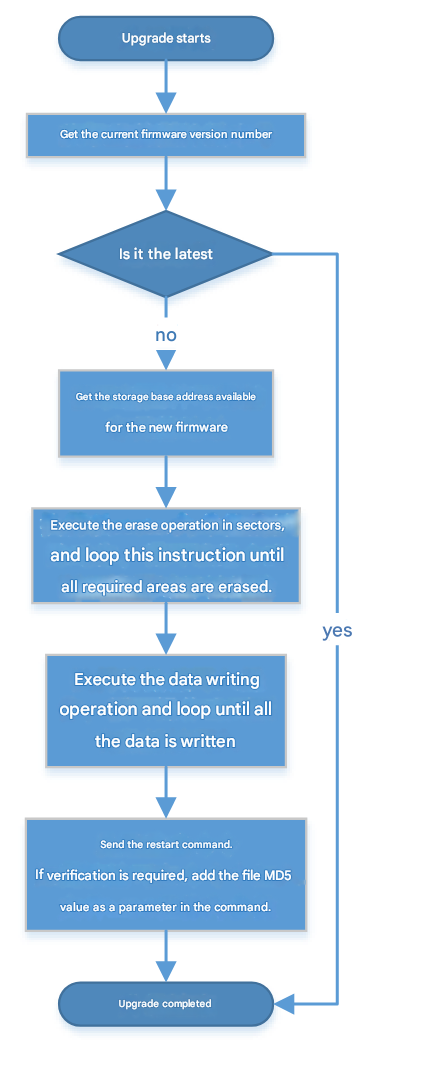

    • 需要提供OTA更新的示例代码 / Example needed for OTA update
      您好,
      能否在您的SDK[1]中添加一个基于GCC可编译运行的OTA更新示例?这将帮助我学习如何添加OTA功能。
      [1] https://gitee.com/freqchip/FR801xH-SDK/tree/master/examples/none_evm
      目前根据中文文档的说明,我了解到需要在项目初始化时调用ota_gatt_add_service()来添加OTA服务。在该手册中...
      在其他文档中我还看到这张经过翻译的示意图...

      Hi,
      Can you please add a working and buildable example with gcc on your SDK [1] that will teach me how to add the OTA update?
      So far looking at your documentation in Chinese I see I need to use call ota_gatt_add_service() to add the OTA service when the project is initialized. In this manual...
      In some other documents I also see this graph which i translated...
