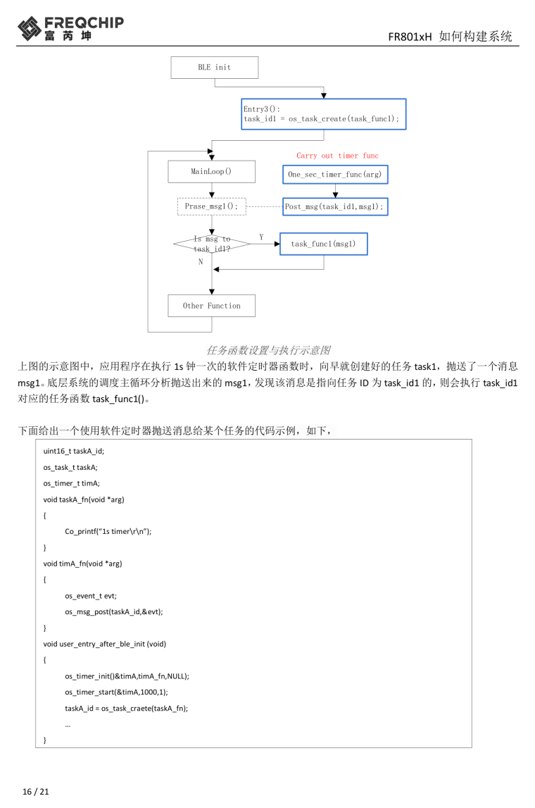

    • RE: 8018HA 跑 ble_simple_peripheral 每隔3小时-5分钟 Crash dump
      LR = 0x010109B5 对应 os_msg_post
      i.os_msg_post 0x01010994 Section 0 os_msg_q.o(i.os_msg_post)
      i.os_task_create 0x010109f4 Section 0 os_task.o(i.os_task_create)
      PC = 0x000008CE 对应 memcpy
      __aeabi_memcpy8 0x000008c5 Thumb Code 0 syscall.txt ABSOLUTE
      __aeabi_memset 0x000008e9 Thumb Code 0 syscall.txt ABSOLUTE
      user code:50HZ 方波输出
      void timA_fn(void *arg)
      os_event_t Timer_event;
      Timer_event.event_id = USER_EVT_TIMER;
      os_msg_post(user_task_id,&Timer_event);
      貌似是库里出问题?
