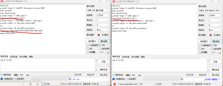

    • RE: FR8018主从连接异常
      这个bond_check_find_devs_idx是干嘛用的呢?

    • FR8018主从连接异常
      FR8018主从连接异常
      两个从机程序相同,由主机扫描到后进行连接,一个连接正常可以通信,另一个异常
      正常从机打印:
      link_lost
      p_event->type:5 Link[0] disconnect,reason:0x08
      link_created
      Stop advertising...
      p_event->type:3 addr_type:0
      bond_check_find_devs_idx:0
      p_event->type:1 slave[0],connect. link_num:1
      p_event->type:11 adv_end,status:0x00
      e_r
      p_event->type:25 slave[0]_encrypted
      char2_recv:0x01,0x02,0x03,0x04,0x05,0x06,0x07,
      param_timer_func
      p_event->type:8 Link[0]param update,interval:12,latency:55,timeout:600
      char2_recv:0xAA,0x01,0x0A,0xB5,
      char2_recv:0xAA,0x01,0x09,0xB4,
      异常从机打印:
      link_lost
      link_created
      Stop advertising...
      e_r
      param_timer_func
