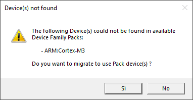

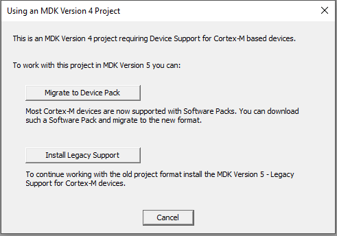

When i double click on the file "ble_simple_peripheral.uvproj", keil starts and display this form, i selected "Migrate to Device Pack", it's right?After this selection appear this window that i close because i don't know what to select, it's right?
After that keil asked me if i want to migrato to use pack device, i selected Yes, it's right?

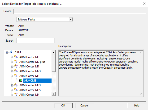

Here i selected this device, it's right?

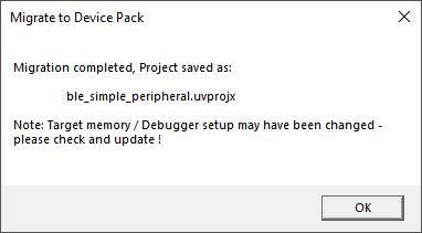

This window confirm the migration

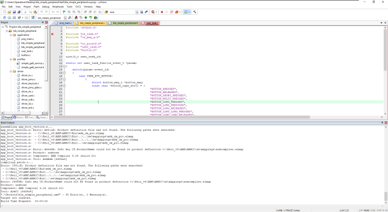

Then when i try to compile there are a lot of errors

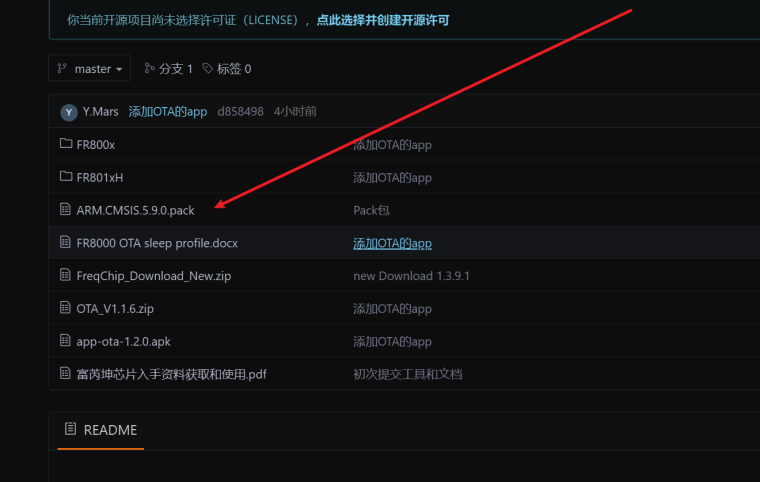

https://gitee.com/YgqMars/freqchip
1、It is recommended that you use it keil V528 https://armkeil.blob.core.windows.net/eval/MDK528.EXE

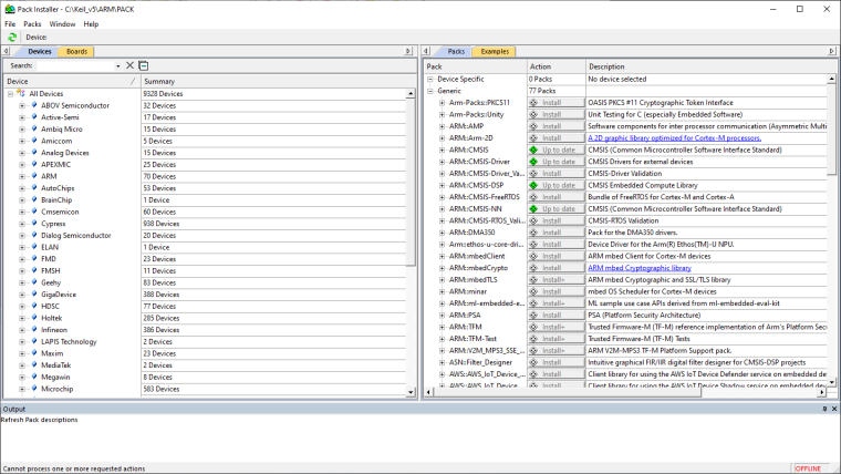

2、Solve pop-up window M3 to install this .pack
