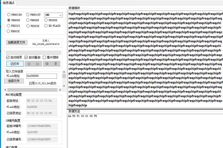

<?xml version="1.0" encoding="UTF-8"?><rss xmlns:dc="http://purl.org/dc/elements/1.1/" xmlns:content="http://purl.org/rss/1.0/modules/content/" xmlns:atom="http://www.w3.org/2005/Atom" version="2.0"><channel><title><![CDATA[8008怎么烧录]]></title><description><![CDATA[<p><img src="/assets/uploads/files/1779788927449-fc364d6e-490b-47bc-8fb7-e74367f75f9b-image-resized.png" alt="0_1779788927550_fc364d6e-490b-47bc-8fb7-e74367f75f9b-image.png" class="img-responsive img-markdown" /><br />
有供电，串口共地，一直打印乱码也烧录不了是什么问题</p>
]]></description><link>http://www.freqchip.net:4567/topic/1814/8008怎么烧录</link><generator>RSS for Node</generator><lastBuildDate>Tue, 02 Jun 2026 18:49:31 GMT</lastBuildDate><atom:link href="http://www.freqchip.net:4567/topic/1814.rss" rel="self" type="application/rss+xml"/><pubDate>Tue, 26 May 2026 09:50:40 GMT</pubDate><ttl>60</ttl><item><title><![CDATA[Reply to 8008怎么烧录 on Invalid Date]]></title><description><![CDATA[<p><img src="/assets/uploads/files/1779788927449-fc364d6e-490b-47bc-8fb7-e74367f75f9b-image-resized.png" alt="0_1779788927550_fc364d6e-490b-47bc-8fb7-e74367f75f9b-image.png" class="img-responsive img-markdown" /><br />
]]></description><link>http://www.freqchip.net:4567/post/4431</link><guid isPermaLink="true">http://www.freqchip.net:4567/post/4431</guid><dc:creator><![CDATA[电话费ID回复]]></dc:creator><pubDate>Invalid Date</pubDate></item><item><title><![CDATA[Reply to 8008怎么烧录 on Invalid Date]]></title><description><![CDATA[<p>刚装的新片都是这个情况</p>

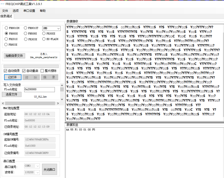

]]></description><link>http://www.freqchip.net:4567/post/4432</link><guid isPermaLink="true">http://www.freqchip.net:4567/post/4432</guid><dc:creator><![CDATA[电话费ID回复]]></dc:creator><pubDate>Invalid Date</pubDate></item><item><title><![CDATA[Reply to 8008怎么烧录 on Invalid Date]]></title><description><![CDATA[<p><img src="/assets/uploads/files/1779805312303-17970abb-daf1-4a56-98e7-ba4cbd4d6e42-image-resized.png" alt="0_1779805313841_17970abb-daf1-4a56-98e7-ba4cbd4d6e42-image.png" class="img-responsive img-markdown" /> 打开烧录也烧录不了，只有放开后有打印</p>
]]></description><link>http://www.freqchip.net:4567/post/4433</link><guid isPermaLink="true">http://www.freqchip.net:4567/post/4433</guid><dc:creator><![CDATA[电话费ID回复]]></dc:creator><pubDate>Invalid Date</pubDate></item><item><title><![CDATA[Reply to 8008怎么烧录 on Invalid Date]]></title><description><![CDATA[<p>兄弟你用的哪个芯片8008gp吗，把这里<img src="/assets/uploads/files/1779848266440-3b90c915-7b73-4152-8130-5e9500de7fdb-image.png" alt="0_1779848267455_3b90c915-7b73-4152-8130-5e9500de7fdb-image.png" class="img-responsive img-markdown" /> 改到8mb试试，然后把<img src="/assets/uploads/files/1779848319919-1cfc4a03-361c-4a89-b0b6-19e38a3bcafb-image.png" alt="0_1779848320975_1cfc4a03-361c-4a89-b0b6-19e38a3bcafb-image.png" class="img-responsive img-markdown" /> 这两个bin文件使用合并工具合成一个bin文件然后在烧入试试</p>
]]></description><link>http://www.freqchip.net:4567/post/4435</link><guid isPermaLink="true">http://www.freqchip.net:4567/post/4435</guid><dc:creator><![CDATA[而优则]]></dc:creator><pubDate>Invalid Date</pubDate></item></channel></rss>
