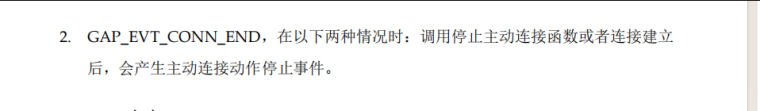

]]></description><link>http://www.freqchip.net:4567/post/4329</link><guid isPermaLink="true">http://www.freqchip.net:4567/post/4329</guid><dc:creator><![CDATA[fu]]></dc:creator><pubDate>Invalid Date</pubDate></item><item><title><![CDATA[Reply to FR8016ha conn_end,reason:0x00 on Invalid Date]]></title><description><![CDATA[<p><a class="plugin-mentions-user plugin-mentions-a" href="http://www.freqchip.net:4567/uid/1889">@fu</a> <img src="/assets/uploads/files/1777339774011-6233e4b8-2589-4382-8818-e4083714f0fb-%E5%9B%BE%E7%89%87-resized.png" alt="0_1777339774241_6233e4b8-2589-4382-8818-e4083714f0fb-图片.png" class="img-responsive img-markdown" /></p>

我拿的是fr801xh_SDK_1043bb7这个里面的SDK，文档也是这个里面的FREQ BLE SDK User Guide V1.0.8.pdf，<br />
它里面描述 GAP_EVT_CONN_END //!&lt; 主动连接的动作未完成，被主动停止。</p>
<p>最新的SDK跟文档能给一个链接么？</p>
]]></description><link>http://www.freqchip.net:4567/post/4334</link><guid isPermaLink="true">http://www.freqchip.net:4567/post/4334</guid><dc:creator><![CDATA[fu]]></dc:creator><pubDate>Invalid Date</pubDate></item><item><title><![CDATA[Reply to FR8016ha conn_end,reason:0x00 on Invalid Date]]></title><description><![CDATA[<p><a class="plugin-mentions-user plugin-mentions-a" href="http://www.freqchip.net:4567/uid/1889">@fu</a> 链路断开是disconnect呢个事件</p>
]]></description><link>http://www.freqchip.net:4567/post/4335</link><guid isPermaLink="true">http://www.freqchip.net:4567/post/4335</guid><dc:creator><![CDATA[ZR]]></dc:creator><pubDate>Invalid Date</pubDate></item></channel></rss>
