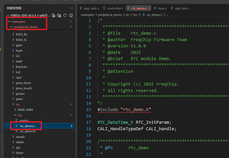

]]></description><link>http://www.freqchip.net:4567/post/4633</link><guid isPermaLink="true">http://www.freqchip.net:4567/post/4633</guid><dc:creator><![CDATA[Mars]]></dc:creator><pubDate>Invalid Date</pubDate></item><item><title><![CDATA[Reply to FR802唤醒源 on Invalid Date]]></title><description><![CDATA[<p>睡眠RTC唤醒有参考例程吗？然后关闭BLE广播的情况下，RTC也能唤醒吗</p>
]]></description><link>http://www.freqchip.net:4567/post/4636</link><guid isPermaLink="true">http://www.freqchip.net:4567/post/4636</guid><dc:creator><![CDATA[JDBJXB]]></dc:creator><pubDate>Invalid Date</pubDate></item><item><title><![CDATA[Reply to FR802唤醒源 on Invalid Date]]></title><description><![CDATA[<p>sdk里面有rtc的demo自行烧录验证，rtc功能正常就可以移到你的工程里面进行休眠验证<br />
<img src="/assets/uploads/files/1787882626303-03debb97-fe98-43b0-bf1a-9905c10dd736-image-resized.png" alt="0_1787882625642_03debb97-fe98-43b0-bf1a-9905c10dd736-image.png" class="img-responsive img-markdown" /></p>

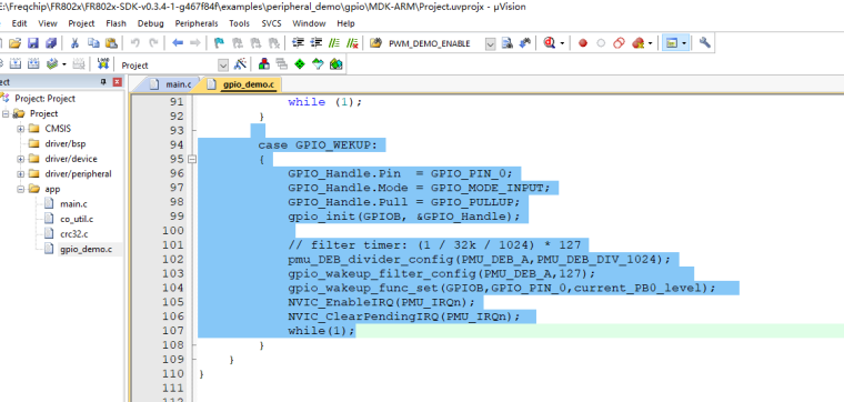

]]></description><link>http://www.freqchip.net:4567/post/4638</link><guid isPermaLink="true">http://www.freqchip.net:4567/post/4638</guid><dc:creator><![CDATA[Mars]]></dc:creator><pubDate>Invalid Date</pubDate></item><item><title><![CDATA[Reply to FR802唤醒源 on Invalid Date]]></title><description><![CDATA[<p><a class="plugin-mentions-user plugin-mentions-a" href="http://www.freqchip.net:4567/uid/941">@mars</a> 现在实现了RTC唤醒，想再增加一个唤醒路径，IO唤醒有示例吗，想使用PC1上升沿唤醒</p>
]]></description><link>http://www.freqchip.net:4567/post/4649</link><guid isPermaLink="true">http://www.freqchip.net:4567/post/4649</guid><dc:creator><![CDATA[JDBJXB]]></dc:creator><pubDate>Invalid Date</pubDate></item><item><title><![CDATA[Reply to FR802唤醒源 on Invalid Date]]></title><description><![CDATA[<p><a class="plugin-mentions-user plugin-mentions-a" href="http://www.freqchip.net:4567/uid/1666">@jdbjxb</a> <img src="/assets/uploads/files/1788829240097-ff8eace4-8518-404c-b1f9-cce5b63f73cc-image-resized.png" alt="0_1788829239914_ff8eace4-8518-404c-b1f9-cce5b63f73cc-image.png" class="img-responsive img-markdown" /> 看一下这个demo</p>
