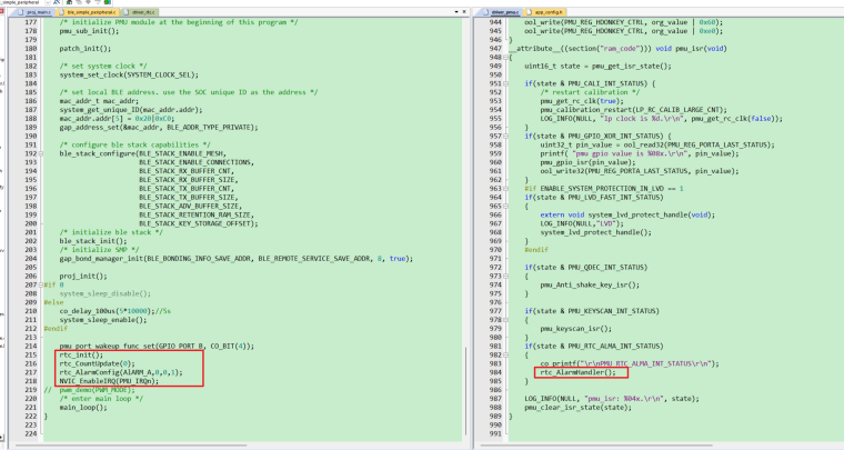

]]></description><link>http://www.freqchip.net:4567/post/4622</link><guid isPermaLink="true">http://www.freqchip.net:4567/post/4622</guid><dc:creator><![CDATA[yjx]]></dc:creator><pubDate>Invalid Date</pubDate></item><item><title><![CDATA[Reply to FR8008GP-U RTC例程有没有？ on Invalid Date]]></title><description><![CDATA[<p><img src="/assets/uploads/files/1787644290142-6eef0dac-8e35-4b2b-9edc-c90dba0f38c1-19c6922a430e8bfa185f50b08a9c4047-resized.png" alt="0_1787644286262_6eef0dac-8e35-4b2b-9edc-c90dba0f38c1-19c6922a430e8bfa185f50b08a9c4047.png" class="img-responsive img-markdown" /></p>
<p>RTC.c驱动部分</p>
