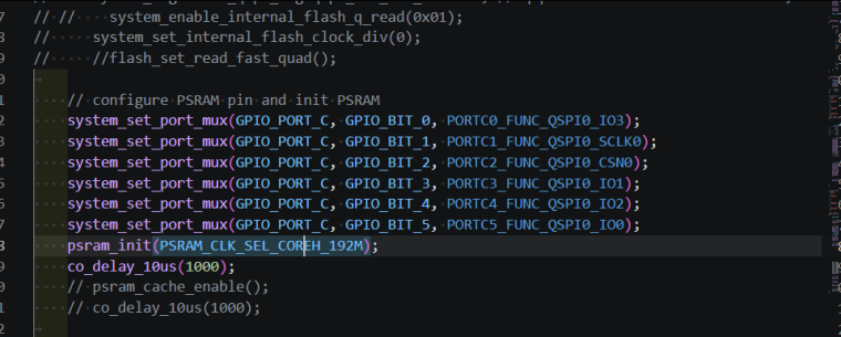

<pre><code>__SYSTEM_GPIO_CLK_ENABLE();
system_regs-&gt;mdm_qspi_cfg.qspi_ref_128m_en = 1; // configure qspi reference clock to 128MHz
system_regs-&gt;mdm_qspi_cfg.qspi_ref_clk_sel = 1; // qspi is used for internal flash, set its reference clock to 96MHz
// system_enable_internal_flash_q_read(0x01);
system_set_internal_flash_clock_div(0);
// configure PSRAM pin and init PSRAM
system_set_port_mux(GPIO_PORT_C, GPIO_BIT_0, PORTC0_FUNC_QSPI0_IO3);
system_set_port_mux(GPIO_PORT_C, GPIO_BIT_1, PORTC1_FUNC_QSPI0_SCLK0);
system_set_port_mux(GPIO_PORT_C, GPIO_BIT_2, PORTC2_FUNC_QSPI0_CSN0);
system_set_port_mux(GPIO_PORT_C, GPIO_BIT_3, PORTC3_FUNC_QSPI0_IO1);
system_set_port_mux(GPIO_PORT_C, GPIO_BIT_4, PORTC4_FUNC_QSPI0_IO2);
system_set_port_mux(GPIO_PORT_C, GPIO_BIT_5, PORTC5_FUNC_QSPI0_IO0);
psram_init(PSRAM_CLK_SEL_COREH_96M);
</code></pre>
</code></pre>

<img src="/assets/uploads/files/1787217930713-5a69fe4f-99d3-40e2-95d9-622129e4d627-%E5%9B%BE%E7%89%87-resized.png" alt="0_1787217931959_5a69fe4f-99d3-40e2-95d9-622129e4d627-图片.png" class="img-responsive img-markdown" /></p>
<p>最高可以192m</p>
]]></description><link>http://www.freqchip.net:4567/post/4614</link><guid isPermaLink="true">http://www.freqchip.net:4567/post/4614</guid><dc:creator><![CDATA[ZR]]></dc:creator><pubDate>Invalid Date</pubDate></item><item><title><![CDATA[Reply to FR8008G-U 蓝牙和LVGL同时运行 LVGL使用外部PSRAM运行比较卡 on Invalid Date]]></title><description><![CDATA[<p>#include &lt;stdint.h&gt;<br />

1、当前SDK没有192M的配置 确认是可以直接改成192M？<br />
2、    uint32_t bytes = ref_clk / 240000; 请问这个240000是什么意思，是否可以调整？</p>
