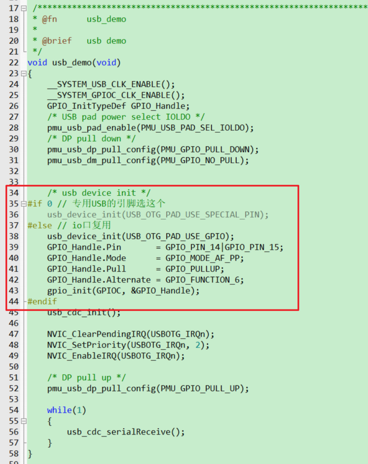

]]></description><link>http://www.freqchip.net:4567/post/4558</link><guid isPermaLink="true">http://www.freqchip.net:4567/post/4558</guid><dc:creator><![CDATA[Mars]]></dc:creator><pubDate>Invalid Date</pubDate></item><item><title><![CDATA[Reply to FR802x原始SDK的USB无法识别的问题 on Invalid Date]]></title><description><![CDATA[<p><img src="/assets/uploads/files/1783932568406-f6567525-2b40-4572-89b3-708afabd0270-d20504979bf78bd101cdf271de101dec-resized.png" alt="0_1783932568058_f6567525-2b40-4572-89b3-708afabd0270-d20504979bf78bd101cdf271de101dec.png" class="img-responsive img-markdown" /><br />
修改办法参考上面</p>
