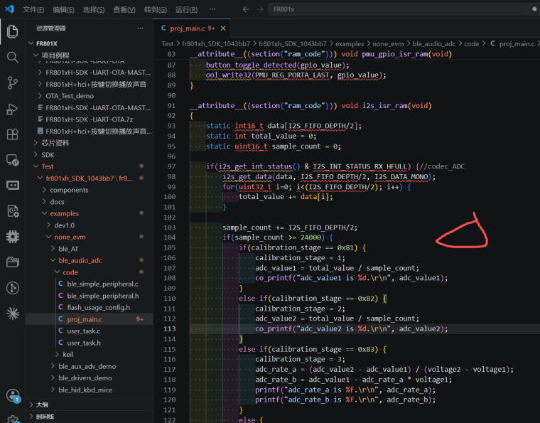

<p><img src="/assets/uploads/files/1783561758423-c4c41251-4626-4290-a120-859c461a291f-%E5%9B%BE%E7%89%87-resized.png" alt="0_1783561757091_c4c41251-4626-4290-a120-859c461a291f-图片.png" class="img-responsive img-markdown" /></p>
<p>直接再这个终端中保存数据然后在循环中把他写进flash就行，flash_write()</p>
