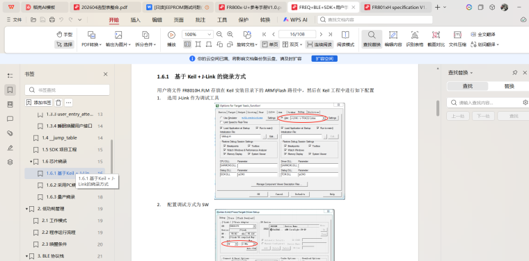

<img src="/assets/uploads/files/1782888596835-e52156d4-4f0c-4456-9c2e-36c5073d1f20-%E5%9B%BE%E7%89%87-resized.png" alt="0_1782888596076_e52156d4-4f0c-4456-9c2e-36c5073d1f20-图片.png" class="img-responsive img-markdown" /></p>
<p>看下这个章节，用例程测试看看，IO不要复用成别的功能</p>
