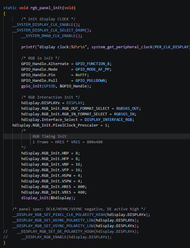

由于800</em>480的数据太大故分包发送<br />
相关配置如下<br />
<img src="/assets/uploads/files/1781772671125-3db69bca-c25c-4829-80ee-333a04b692c5-image.png" alt="0_1781772670248_3db69bca-c25c-4829-80ee-333a04b692c5-image.png" class="img-responsive img-markdown" /><br />
<img src="/assets/uploads/files/1781772713014-a68256fe-5fc2-4ec5-96dc-501fbb555c43-image-resized.png" alt="0_1781772712193_a68256fe-5fc2-4ec5-96dc-501fbb555c43-image.png" class="img-responsive img-markdown" /><br />

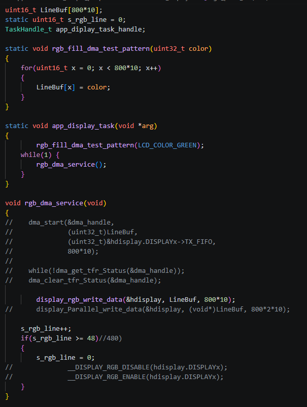

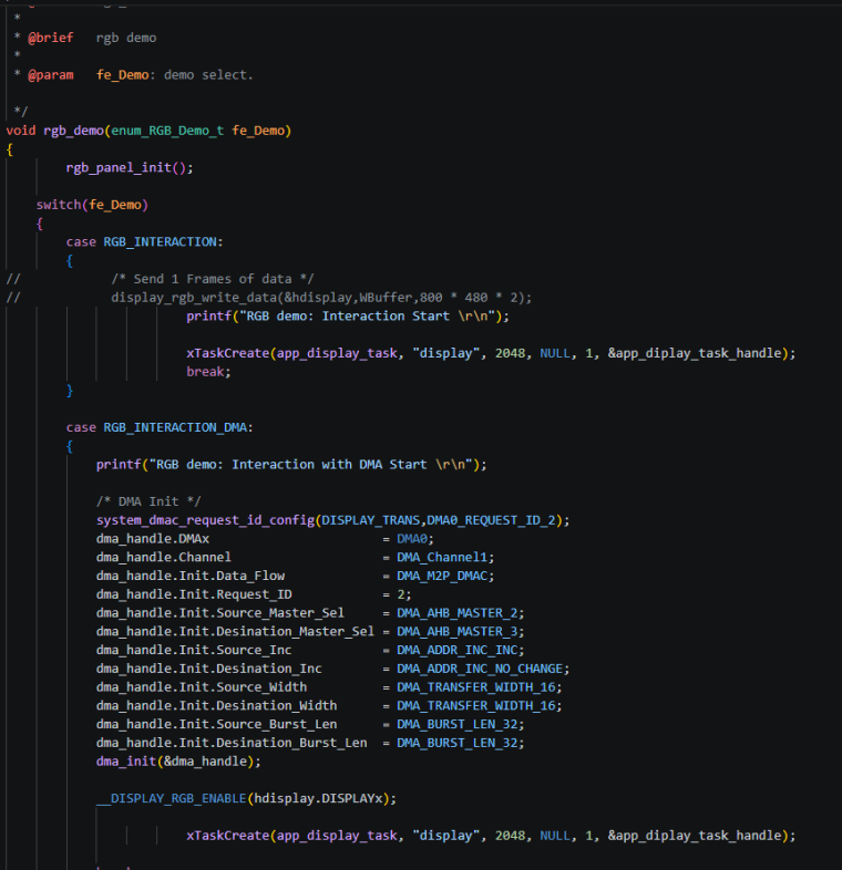

发送函数：<br />
<img src="/assets/uploads/files/1781772776642-2d874f49-8fa5-4cfc-a8ed-458ee74ffc5a-image.png" alt="0_1781772775843_2d874f49-8fa5-4cfc-a8ed-458ee74ffc5a-image.png" class="img-responsive img-markdown" /><br />
尝试过多种方式当时都存在异常要么只亮背光、要么颜色跟传输颜色不一致<br />

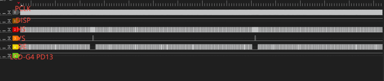

使用逻辑分析仪读信号 hs vs de pclk 均有信号（高低电平） disp正常为高 但是抓取lcd-G4 却一直高<br />
<img src="/assets/uploads/files/1781773252114-16484826-0a58-4288-a2e5-10db1fd62dc5-image-resized.png" alt="0_1781773251257_16484826-0a58-4288-a2e5-10db1fd62dc5-image.png" class="img-responsive img-markdown" /><br />
太异常了 屏幕规格书上时序为de模式  fr306x的参考手册写明了是支持de模式的<br />

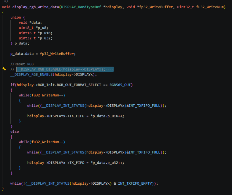

传输数据的函数（修改过）：<br />
<img src="/assets/uploads/files/1781773563434-76b5ce17-5af2-4f24-9bea-4b261594577c-image-resized.png" alt="0_1781773561587_76b5ce17-5af2-4f24-9bea-4b261594577c-image.png" class="img-responsive img-markdown" /></p>

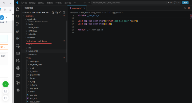

<a href="https://gitee.com/a18562560220/freqchip_faq/blob/master/fr30xxc_sdk_v0.2.3_evb_05d077cc.rar" rel="nofollow">https://gitee.com/a18562560220/freqchip_faq/blob/master/fr30xxc_sdk_v0.2.3_evb_05d077cc.rar</a></p>
<p>看下这个例程</p>
