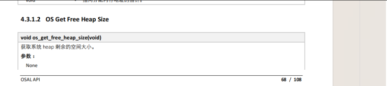

<p><img src="/assets/uploads/files/1777432961938-9e9a6e33-8af1-4d86-80b5-9eaf4ea1d356-%E5%9B%BE%E7%89%87-resized.png" alt="0_1777432962077_9e9a6e33-8af1-4d86-80b5-9eaf4ea1d356-图片.png" class="img-responsive img-markdown" /></p>
<p>监测下堆栈空间</p>
