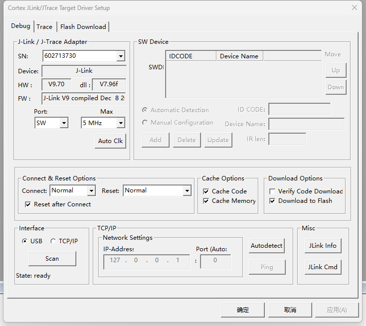

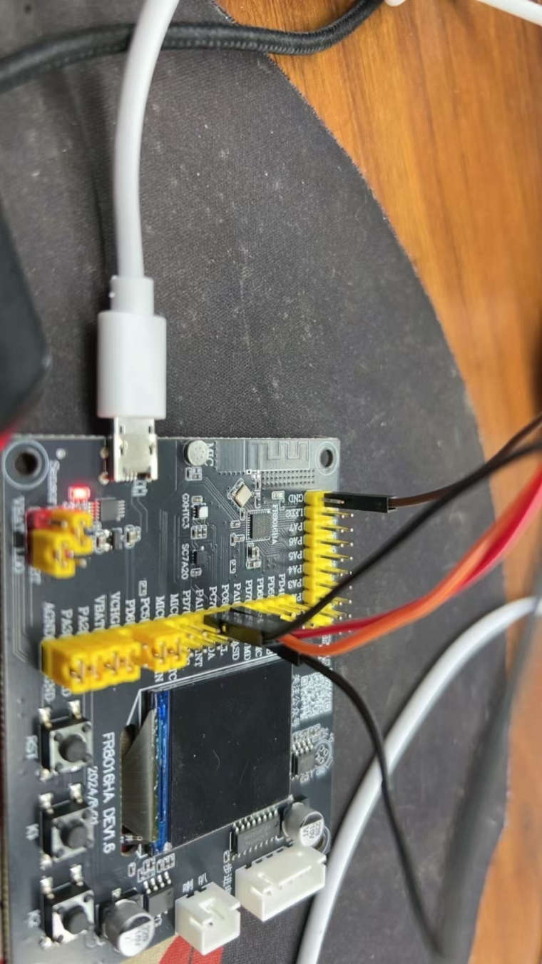

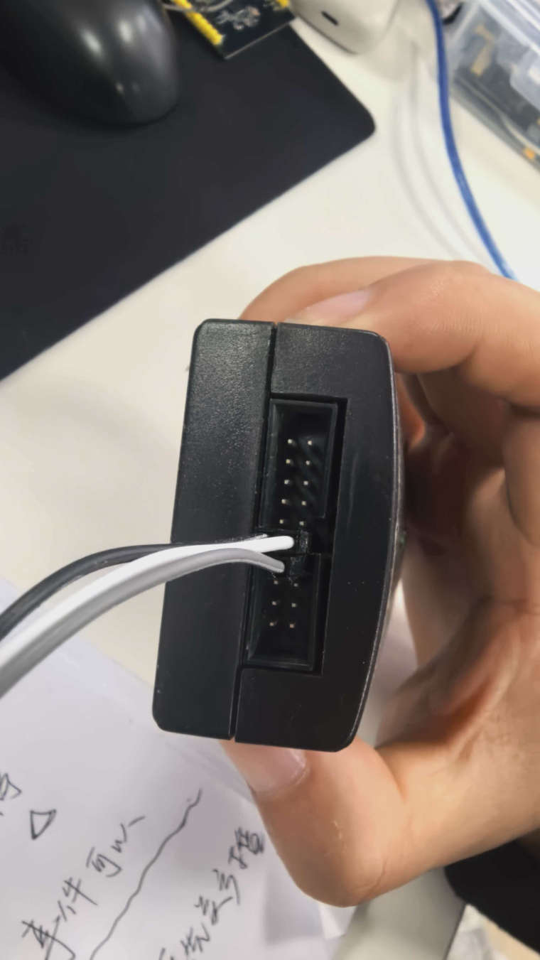

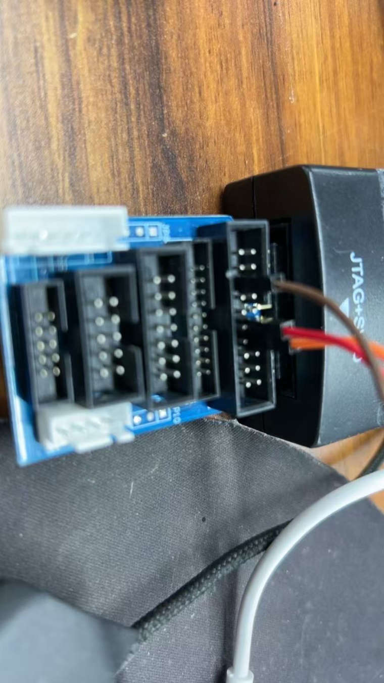

<?xml version="1.0" encoding="UTF-8"?><rss xmlns:dc="http://purl.org/dc/elements/1.1/" xmlns:content="http://purl.org/rss/1.0/modules/content/" xmlns:atom="http://www.w3.org/2005/Atom" version="2.0"><channel><title><![CDATA[想使用Jlink对FR8016HA开发板进行调试，但是连接了PC6 PC7 GND ，KEIL上SW DEVICE上识别不到芯片应该如何处理]]></title><description><![CDATA[<p><img src="/assets/uploads/files/1774502195846-51fcf7dc-dcee-4ed9-b5c9-1a5393a4f387-e0381eb48da34f5de18386a05f9bca9e-resized.jpg" alt="0_1774502195611_51fcf7dc-dcee-4ed9-b5c9-1a5393a4f387-e0381eb48da34f5de18386a05f9bca9e.jpg" class="img-responsive img-markdown" /> <img src="/assets/uploads/files/1774502219514-5f91d10f-0fee-4727-b40d-48bf04c1e5d1-57efa4780ed5e9ebecd16f3e101a4f57-resized.jpg" alt="0_1774502219775_5f91d10f-0fee-4727-b40d-48bf04c1e5d1-57efa4780ed5e9ebecd16f3e101a4f57.jpg" class="img-responsive img-markdown" /> <img src="/assets/uploads/files/1774502250538-cd42c13c-4be2-45b4-a9ec-2b7e9543f0d2-26a00f683fc2315ebd19e6ec90c7cc4c-resized.jpg" alt="0_1774502250053_cd42c13c-4be2-45b4-a9ec-2b7e9543f0d2-26a00f683fc2315ebd19e6ec90c7cc4c.jpg" class="img-responsive img-markdown" /> <img src="/assets/uploads/files/1774502281872-da2d1535-5e41-4135-b583-fa57f6a3a7e8-image.png" alt="0_1774502281434_da2d1535-5e41-4135-b583-fa57f6a3a7e8-image.png" class="img-responsive img-markdown" /></p>

]]></description><link>http://www.freqchip.net:4567/post/4258</link><guid isPermaLink="true">http://www.freqchip.net:4567/post/4258</guid><dc:creator><![CDATA[ZR]]></dc:creator><pubDate>Invalid Date</pubDate></item><item><title><![CDATA[Reply to 想使用Jlink对FR8016HA开发板进行调试，但是连接了PC6 PC7 GND ，KEIL上SW DEVICE上识别不到芯片应该如何处理 on Invalid Date]]></title><description><![CDATA[<p><a class="plugin-mentions-user plugin-mentions-a" href="http://www.freqchip.net:4567/uid/1586">@zr</a> JLINK上的SWCLK接PC6 SWDIO接PC7 GND接地。内部没有程序，已经使用串口烧录工具把flash擦除了</p>
]]></description><link>http://www.freqchip.net:4567/post/4260</link><guid isPermaLink="true">http://www.freqchip.net:4567/post/4260</guid><dc:creator><![CDATA[wl1111]]></dc:creator><pubDate>Invalid Date</pubDate></item><item><title><![CDATA[Reply to 想使用Jlink对FR8016HA开发板进行调试，但是连接了PC6 PC7 GND ，KEIL上SW DEVICE上识别不到芯片应该如何处理 on Invalid Date]]></title><description><![CDATA[<p><a class="plugin-mentions-user plugin-mentions-a" href="http://www.freqchip.net:4567/uid/1586">@zr</a> 速率降到2M了</p>

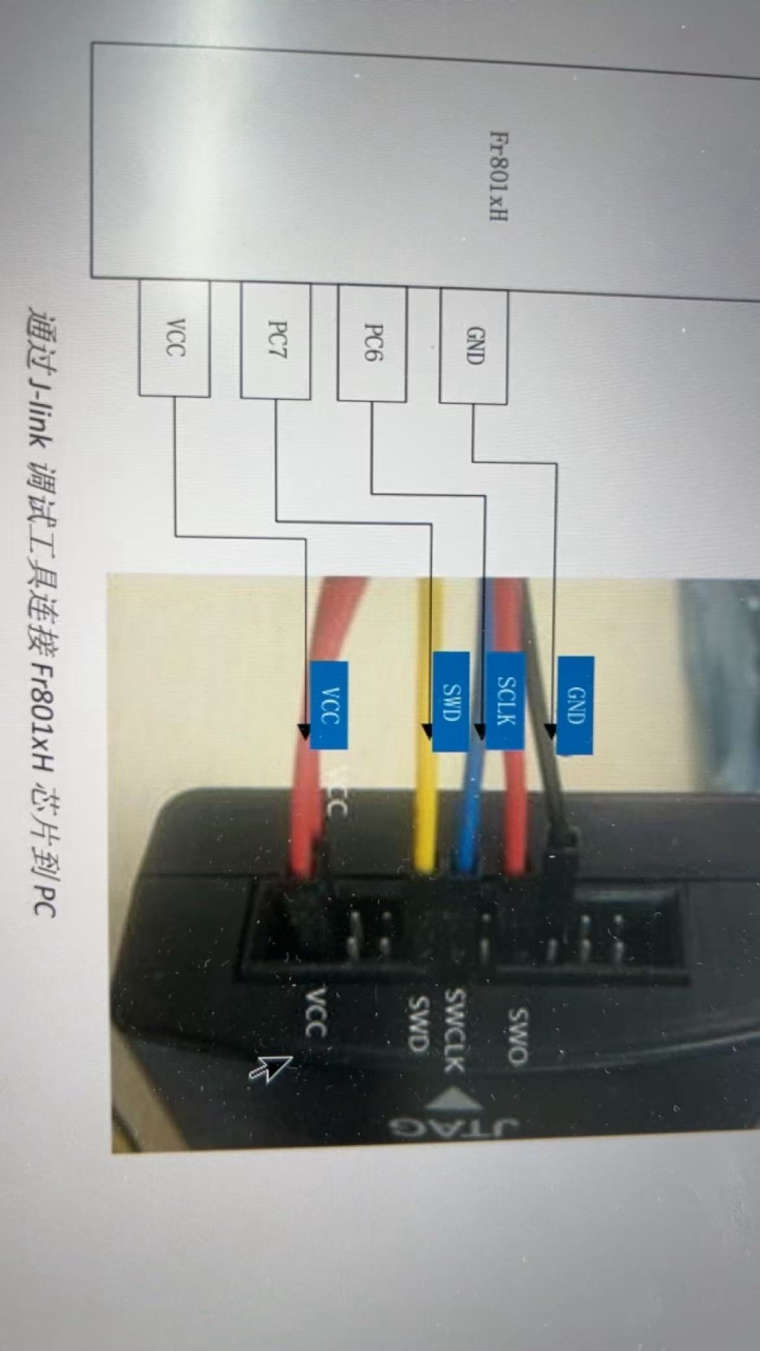

确定接对了？<br />
这么插试试<br />
<img src="/assets/uploads/files/1774516789468-51ce92a9-5736-42d9-b72f-cd80d6092ac2-a36fec063a8b5d4e5d9da130e28c44f2-resized.jpg" alt="0_1774516788298_51ce92a9-5736-42d9-b72f-cd80d6092ac2-a36fec063a8b5d4e5d9da130e28c44f2.jpg" class="img-responsive img-markdown" /></p>
]]></description><link>http://www.freqchip.net:4567/post/4262</link><guid isPermaLink="true">http://www.freqchip.net:4567/post/4262</guid><dc:creator><![CDATA[ZR]]></dc:creator><pubDate>Invalid Date</pubDate></item><item><title><![CDATA[Reply to 想使用Jlink对FR8016HA开发板进行调试，但是连接了PC6 PC7 GND ，KEIL上SW DEVICE上识别不到芯片应该如何处理 on Invalid Date]]></title><description><![CDATA[<p><a class="plugin-mentions-user plugin-mentions-a" href="http://www.freqchip.net:4567/uid/1881">@wl1111</a> 再不行就，更新成最新的jlink驱动</p>
]]></description><link>http://www.freqchip.net:4567/post/4263</link><guid isPermaLink="true">http://www.freqchip.net:4567/post/4263</guid><dc:creator><![CDATA[ZR]]></dc:creator><pubDate>Invalid Date</pubDate></item><item><title><![CDATA[Reply to 想使用Jlink对FR8016HA开发板进行调试，但是连接了PC6 PC7 GND ，KEIL上SW DEVICE上识别不到芯片应该如何处理 on Invalid Date]]></title><description><![CDATA[<p><a class="plugin-mentions-user plugin-mentions-a" href="http://www.freqchip.net:4567/uid/1586">@zr</a> Jlink驱动刚刚更新到最新了</p>
