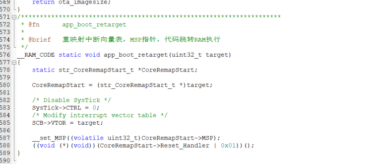

]]></description><link>http://www.freqchip.net:4567/post/4075</link><guid isPermaLink="true">http://www.freqchip.net:4567/post/4075</guid><dc:creator><![CDATA[liurenwoxing]]></dc:creator><pubDate>Invalid Date</pubDate></item><item><title><![CDATA[Reply to 更改FR8008GP向量地址 on Invalid Date]]></title><description><![CDATA[<p><a class="plugin-mentions-user plugin-mentions-a" href="http://www.freqchip.net:4567/uid/1733">@liurenwoxing</a><br />
<img src="/assets/uploads/files/1773642515680-557ee124-cfdb-4932-8bfc-b0a56887266b-%E5%9B%BE%E7%89%87-resized.png" alt="0_1773642515454_557ee124-cfdb-4932-8bfc-b0a56887266b-图片.png" class="img-responsive img-markdown" /></p>

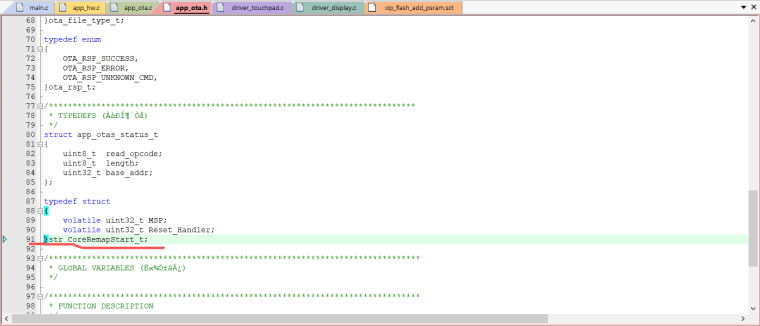

]]></description><link>http://www.freqchip.net:4567/post/4077</link><guid isPermaLink="true">http://www.freqchip.net:4567/post/4077</guid><dc:creator><![CDATA[ZR]]></dc:creator><pubDate>Invalid Date</pubDate></item><item><title><![CDATA[Reply to 更改FR8008GP向量地址 on Mon, 16 Mar 2026 07:07:36 GMT]]></title><description><![CDATA[<p>好的谢谢！另外这个结构体是如何 定义的呢 str_CoreRemapStart_t</p>

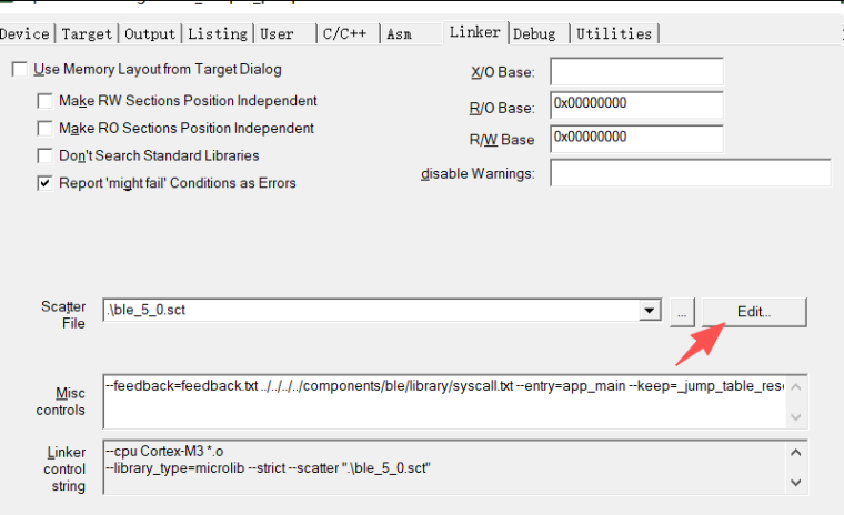

app中的.sct链接文件的起始地址改了吗</p>
